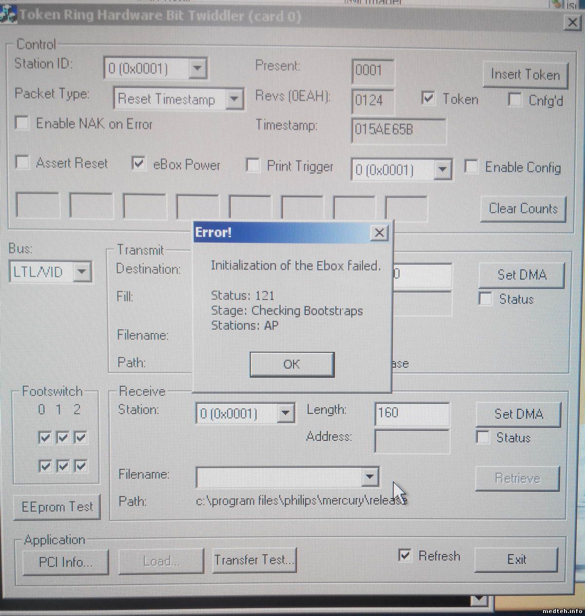

tomiosДата: Вторник, 22.Дек.2015, 00:36 | Сообщение # 290
x-ray, US technical service
Хорватия
Osijek
Hello, I hope it's not problem writing in english, but I found here many good stuff with translator.
I need help about this error ""The instrument has detected an internal error and is collecting information to help diagnose the problem. Please contact your Philips representative. The" Restart "control will be enabled when the information has been collected."
I found that there is problem with e-box and apio driver in event viewer. As I can see, all voltages on power supply are ok (all LED are lit). On first e-box board all green are ok too. Except those on picture. Red LED are lit when I run ultrasound.exe.
https://dl.dropboxusercontent.com/u/70049736/20151221_131715.jpg
https://dl.dropboxusercontent.com/u/70049736/20151221_155253.jpg
Has anyone solve this problem?
Software is 2.0.2
Anyone have image for this version if it's maybe software error?
Thanks in advance!!!
navesДата: Вторник, 22.Дек.2015, 13:08 | Сообщение # 291
У вас сообщений: 1070

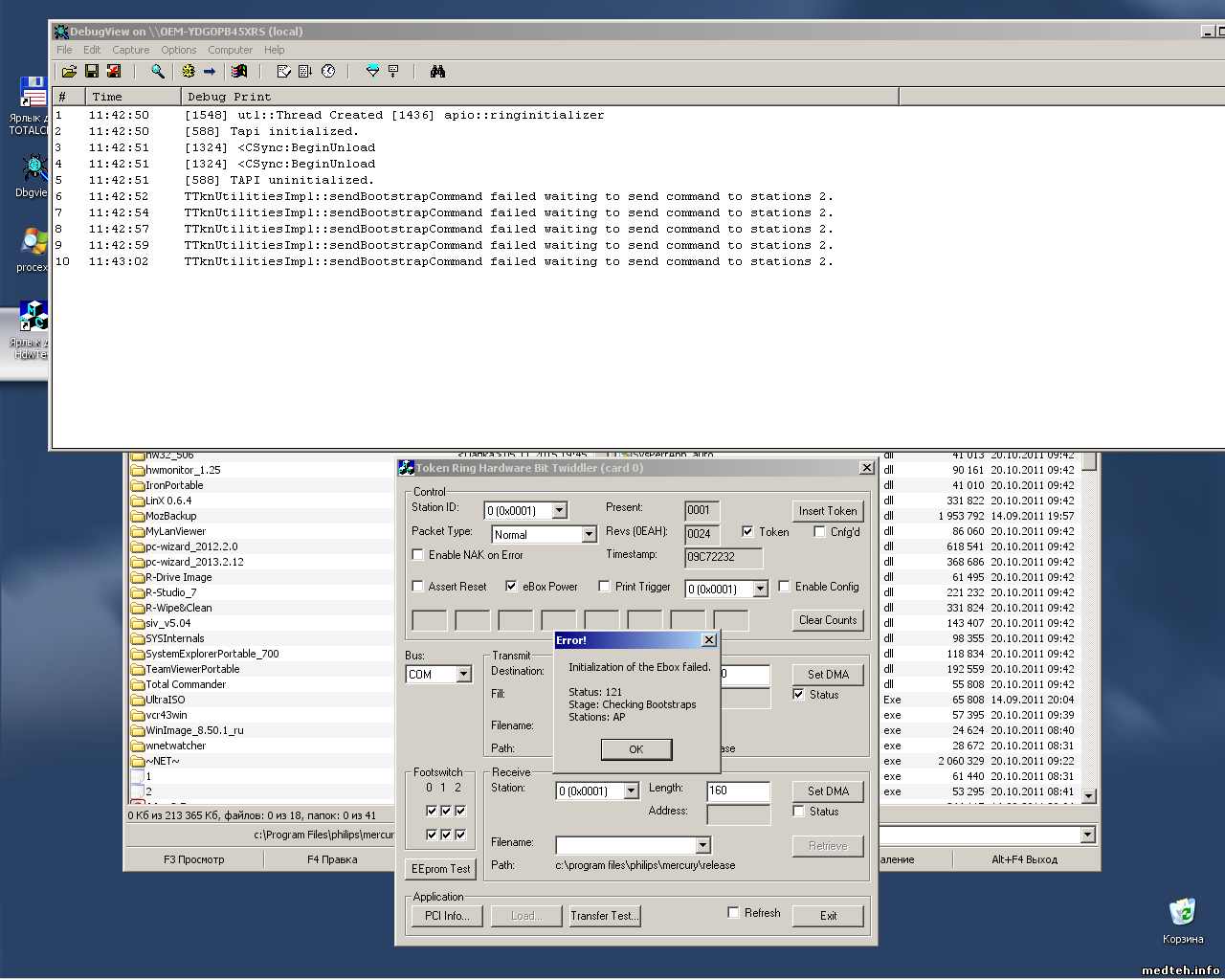

1) try to start
C:\Program Files\philips\mercury\Release\HdwTest.exe
transfer test
with Sysinternals Debug View in background like showed in attach from this post http://www.medteh.info/forum/57-9404-162518-16-1432130474
2) check logs of the power monitor in
E:\Diagnostics\
similar file was shown in spoiler from this post http://www.medteh.info/forum/57-9404-163991-16-1434396715
3) try this acronis image http://www.medteh.info/forum/57-4257-139849-16-1397364853
Сообщение отредактировал naves - Вторник, 22.Дек.2015, 16:15

BomberbugДата: Пятница, 15.Янв.2016, 09:54 | Сообщение # 311
У вас сообщений: 713
engineer
Вобщем DebugView выдает ошибки, что во вложении...
Куда копать?
Сообщение отредактировал Bomberbug - Пятница, 15.Янв.2016, 09:56
navesДата: Пятница, 15.Янв.2016, 10:57 | Сообщение # 312
скриншот с ошибкой ровно как у меня, даже ярлыки на рабочем столе. :yes:
попробуйте так:
включите аппарат минут на 20, типа прогреться
трансфер тест - не работает
нажмите галочку ebox power, не двигайте мышку (или включите монитор к внешнему питалову)
пошевелите плату процессора, можно даже ее загнуть влево
включайте галочкой ебох, делайте тест.
повторить по необходимости
первый месяц мне удавалось так запустить плату, потом видимо догнул ее окончательно.
имхо station 2 это второй ПЛИС на плате, и с ним нет связи. Из-за проблем с платой или питанием неизвестно.
тут нужен reference manual на саму эту плату, но его скорее всего нет, даже у официальных инженеров, только в каком-нибудь головном сервисе.
только замена платы что-то покажет
Сообщение отредактировал naves - Пятница, 15.Янв.2016, 11:16
BomberbugДата: Пятница, 15.Янв.2016, 11:40 | Сообщение # 313
engineer
тут под платой подразумевается та, в которую все 4 воткнуты? (типа "материнская плата") ?
BomberbugДата: Пятница, 15.Янв.2016, 11:44 | Сообщение # 314
engineer
biggrin biggrin biggrin
Мда... Пассы с шевелением помогли.... Тест пошел.....
Я так понимаю, что это "временное решение" и рано иль поздно усе "умрет"?
navesДата: Пятница, 15.Янв.2016, 11:55 | Сообщение # 315
они начинают помогать все реже и реже :)
если есть знакомые hardware инженеры, могут попробовать проверить плисы через JTAG, он там стоит у каждой микрухи
