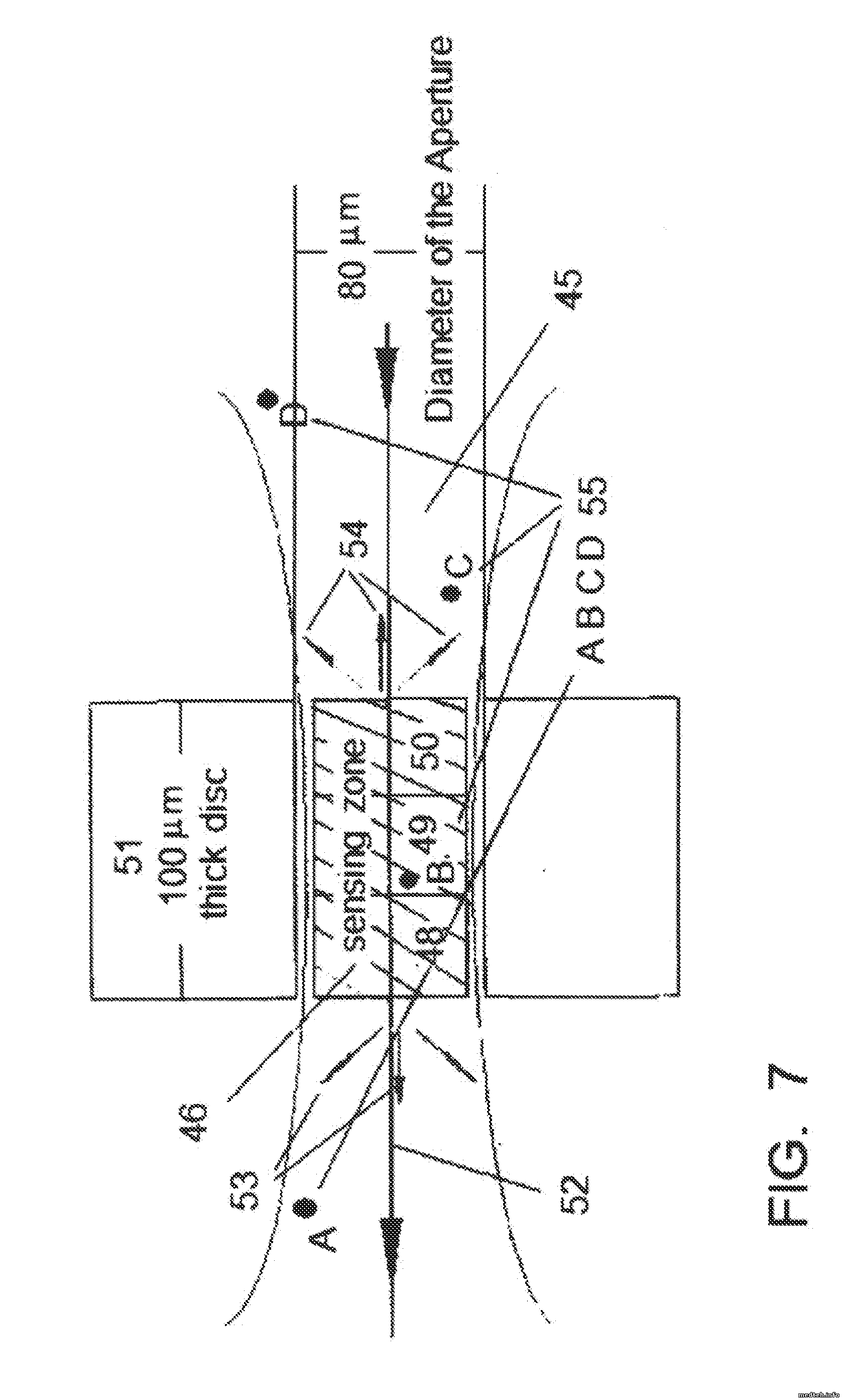

Да, с отверстием сложновато, многое растолковывается в патентах производителей:
FIG. 6 and FIG. 7 illustrate the concept and realization of “Coaxial Illumination of Coulter Aperture”. In FIG. 6 in the center of the aperture disc 42 (thickness of 100 μm) is the Coulter aperture 41 (diameter of 50 μm to 80 μm). Focused laser beam 45 propagates along the common axis 43 (Coaxial illumination) and interacts with cells 44. In FIG. 7 laser beam 45 is focused in the middle of Coulter aperture, also the sensing zone 46, and propagates from right to left along the common axis 52. The diameter of the aperture is 80 μm and the thickness 51 of aperture disc is 100 μm. The fiber coupled laser 80 through fiber 79 entering the focus optics 75 in FIG. 9 and FIG. 10. The focused laser beam is designed to have focused waist about 60 μm to 75 μm (little less than aperture diameter 80 μm) and to have Rayleigh region about several aperture lengths (thickness 51, 100 μm). The focus optics should be designed to meet above two criterions (waist size and Rayleigh region) so the aperture can be illuminated uniformly. The sensing zone 46 can be divided to 3 portions, front portion 50, middle portion 49, and rear portion 48. The cells 55 (A, B, C, D) (see FIG. 7) are all be interrogated with laser beam but only cell B within the sensing zone can be detected, by using the spatial discriminating gate (implemented optically, such as the special designed detection optical system showed in FIG. 9 and FIG. 10) and temporal discriminating gate (implemented electronically). The forward scattering light 53, traveling to left and back scattering light 54, traveling to right, then can be detected by detection optics 81 and 77, respectively in FIG. 9 and FIG. 10.

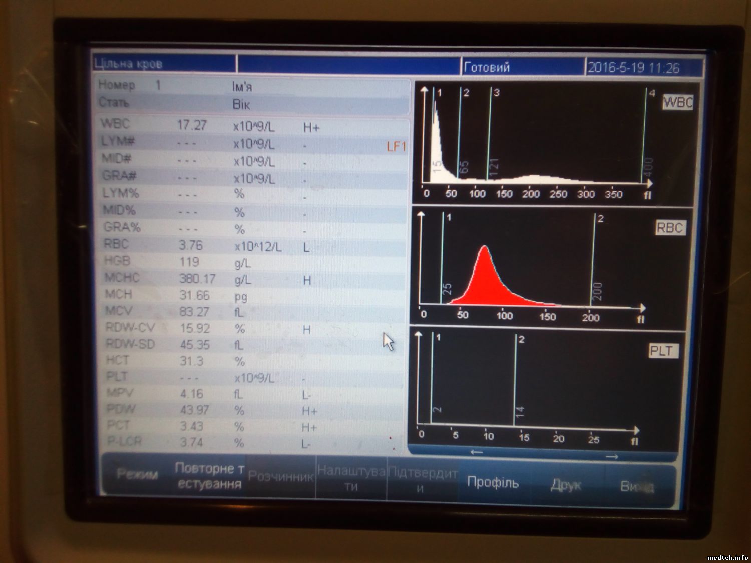

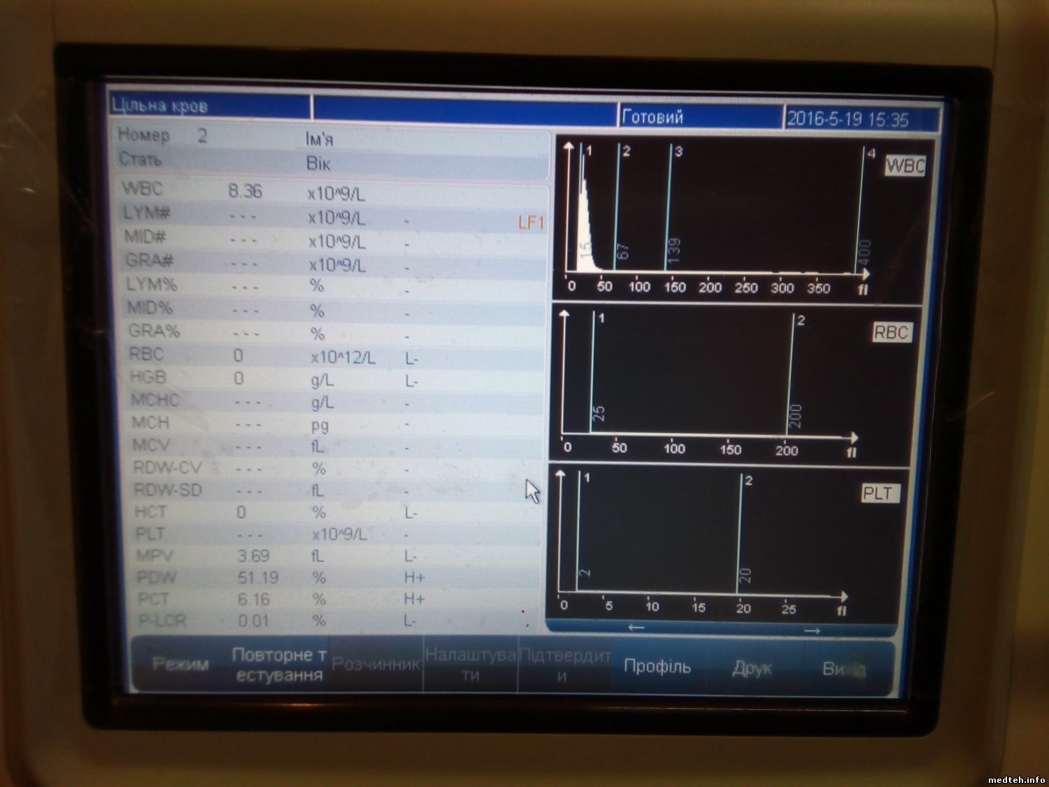

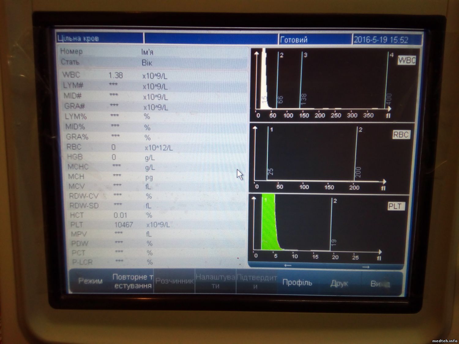

Всем привет!
У нас сейчас в ремонте два аппарата с одинаковым дефектом: не меряют PLT.
Приборы 2014 и 2012 г.в. ТО ни разу не проводилось. Судя по архиву измерений дефект проявился в апреле 2015г. Имела место попытка восстановить работоспособность приборов изменением инженерных настроек в июне 2015г- все в кашу.
При проведении работ по ТО выявлено и устранено:
1.Отсутствие высоковольтного импульса - замена микросхемы LS04 верней платы
2.напряжение на электродах камер, заполненных рабочим раствором 2-4В, следы ударов иглы по дну камер, трещины, прожег стенки камеры в зоне установки апертуры камеры RBC. После герметизации дефектов напряжение поднялось до 12В.
3.Дефект программного обеспечения (самопроизвольная перезагрузка системы) - переустановка ПО
4.Обрыв кабеля камеры WBC
Проведена тщательная промывка.
После всего правильно измеряется только гемоглобин и RBC. Выдается сообщение о перегрузке (overflow) на обоих приборах.
Кто что может посоветовать в данной ситуации?
Гистограммы при включении прибора, анализе бланка и контрольной крови прилагаются.

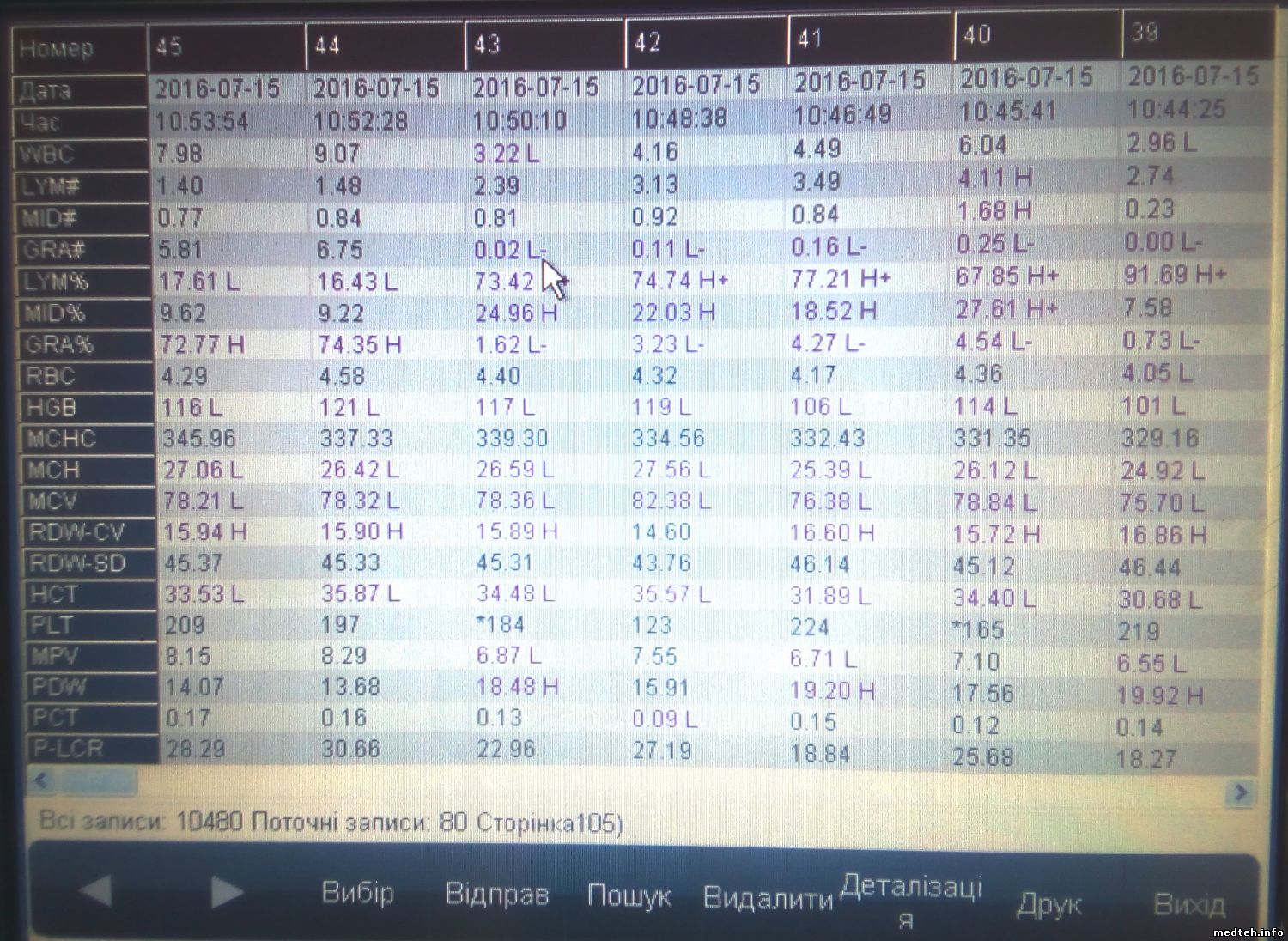

RZVTДата: Пятница, 15.Июл.2016, 12:28 | Сообщение # 182
У вас сообщений: 78
инженер-ремонтник
Кривой Рог

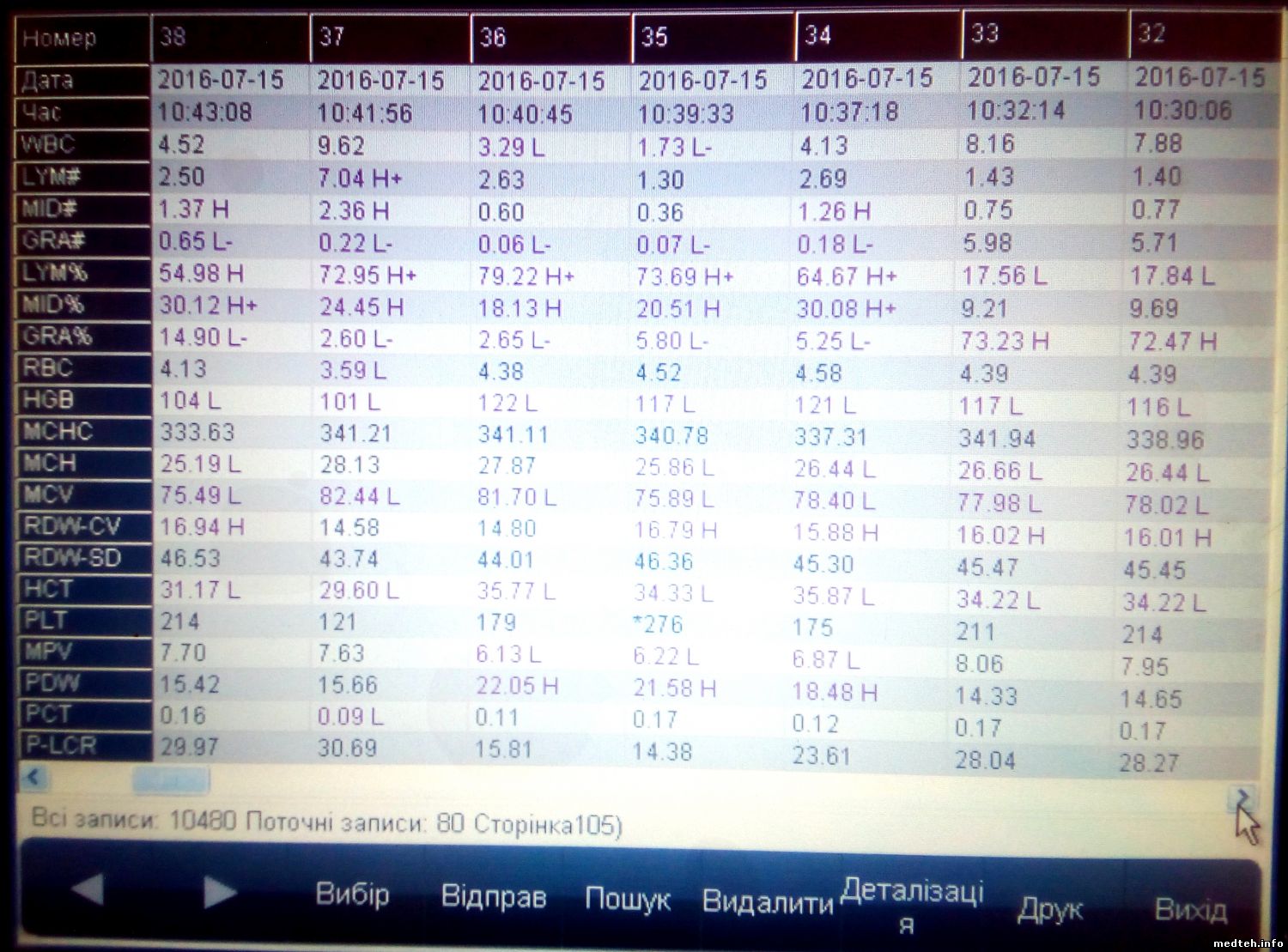

RT-7600 по контрольной крови настраивается легко и работает стабильно. По живой крови результат вызывает сомнения.
Очень сильно завышены лимфоциты
В приложении на фото 1 - 32 и 33-й анализы по контрольной пробе, на фото 2 - 44 и 45 тоже контрольная проба.
В чем проблема?

biotechДата: Пятница, 15.Июл.2016, 16:07 | Сообщение # 183
У вас сообщений: 64
Нужны гистограммы живой крови и контрольной. Сами по себе цифры результата ничего не дают. Нужно видеть какого размера клетки прибор посчитал как лейкоциты и как менялось распределение от измерения к измерению.
Какой уровень бланка получается на лейкоцитах? Фона нет?
Измерения 43-34 это одна и та же проба?
По вашим результатам гранулоцитов при измерении живой крови устойчиво мало. График смещен левее объема 150 Фл? Если да, то нужно разбираться с дозированием лизирующего раствора. Возможно его добавляется слишком много, что приводит к сжиманию клеток. На контрольной крови такого эффекта не наблюдается, т.к. там лейкоциты чаще всего моделируются латексными частицами, а на них разница осмотических давлений не влияет.
RZVTДата: Пятница, 15.Июл.2016, 16:47 | Сообщение # 184
У вас сообщений: 78
инженер-ремонтник
Кривой Рог
biotech:
При измерении бланка все по нолям, фона нет. Измерения 43-34 разные пробы.
По поводу смещения графика - скорее да, по сравнению с контрольной пробой, он существенно смещен влево.
Передозировка раствора - возможно была. Он залил светодиод, в результате выводы сгнили и отпали. Новый светодиод, как ни странно, оказался интенсивным источником шумов, пришлось подбирать и ограничивать ток.
Может подобное иметь место при использовании растворов с критическим сроком годности?
Как правильно отрегулировать дозирование?
Я должен видеть, чем я дышу

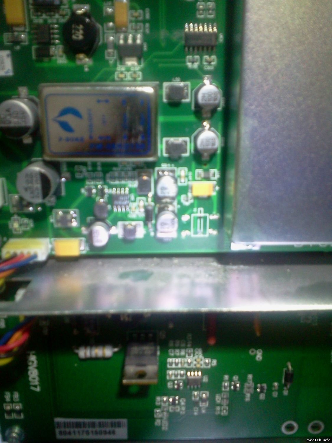

FerrymanДата: Среда, 31.Авг.2016, 09:50 | Сообщение # 192
У вас сообщений: 29
Добрый день форумчане!
Поступил в ремонт аппарат MD-7600. Проблема в следующем, на плате управления клапанами находиться клапан обозначен 605F 201116N (Т1), что это такое кто знает? Похоже он не работает, залило водой из вакуум насоса,после выхода из строя клапана 5. Теперь насос начинает дёргаться пока не снимеш трубку трубку с насоса или клапана.После чего прибор начинает работать.
Leopold
Сообщение отредактировал Ferryman - Среда, 31.Авг.2016, 10:00
AlexiumДата: Среда, 31.Авг.2016, 11:48 | Сообщение # 193
Шизофрения???
