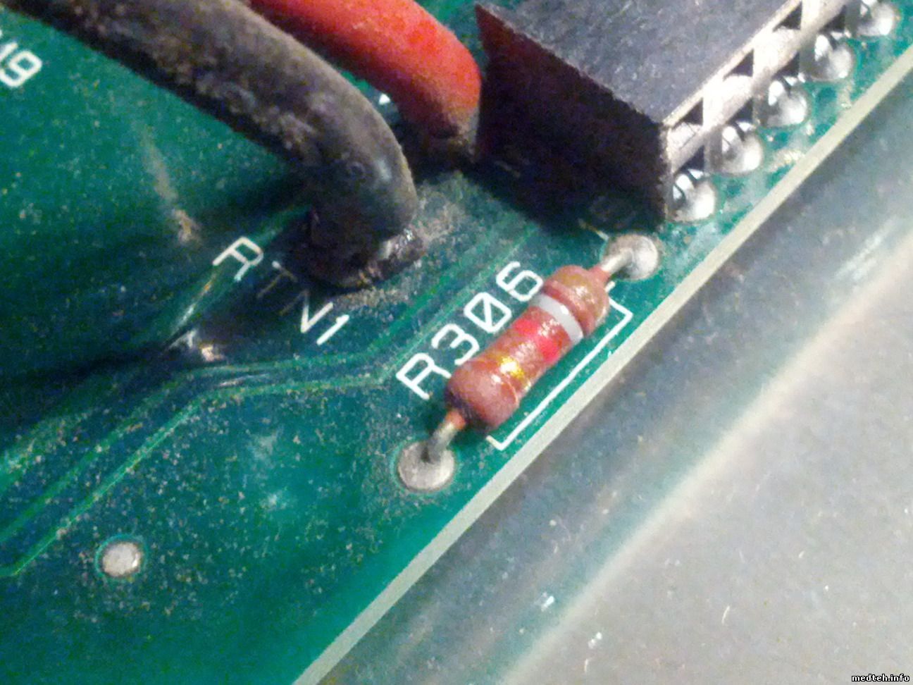

Заменил элементы, но опять сгорел R306.
Подскажите, пожалуйста, почему этот резистор сгорает ...
Thank you very much.
I replaced components but R306 burnt out again.
This time MOSFET 2N7002, Zener diode 27V and resistors are seems good.

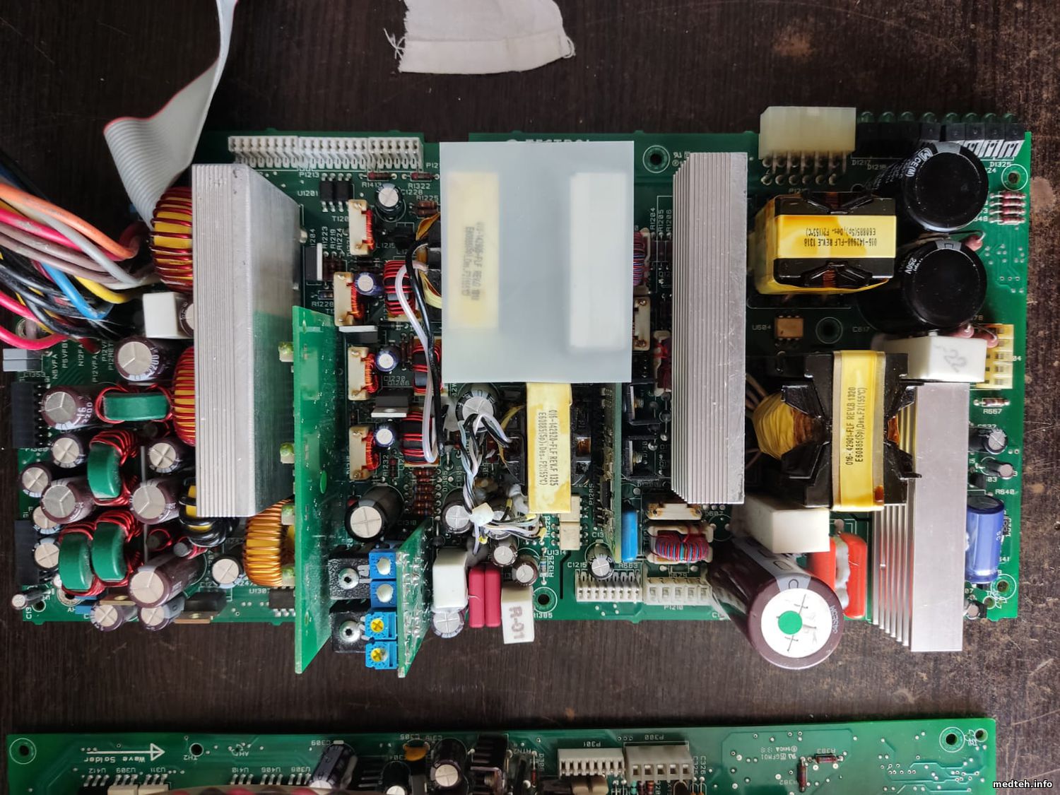

Please tell me what shall I check, what is reason that resistor is burn out?
You're welcome.
There are black and red wires coming from the bridge diode on the power supply body. If you insert these cables into the places on the card, the parts I marked and the R306 will be damaged. B+ red, B- black cable needs to be installed. The R306 resistor is connected to the drain leg of the Q300 mosfet. Are you sure the mosfet isn't faulty?
Good luck.

lhagva99Дата: Суббота, 25.Июн.2022, 14:14 | Сообщение # 86
Монголия
Улан-Батор
Hello.
I replaced R306 and Q300.
Now AC OK Led is ON and I can hear relay is working when input power.
But it seems that Standby power is not coming. (Power button LED is blank)
I checked AC from the power supply board to the Personal Computer (top receptacle, white and black wires) there is just 0.2V.
N_PWR ON is 3.38V, and AC OK is 0.168V DC.
Please tell me what point shall I check?

efecelebiДата: Понедельник, 27.Июн.2022, 11:41 | Сообщение # 87
У вас сообщений: 132
Electronic Technician
Германия
Bavyera
Цитата lhagva99 ()
I have two questions.
1. Can I switch on Power supply without Personal computer and backplane board. If yes how can I switch on.
2. There are two white connectors from the power supply to the backplane board.
I think connector with LV, 2.5V and 3.3V is upper one, am I right?

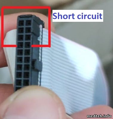

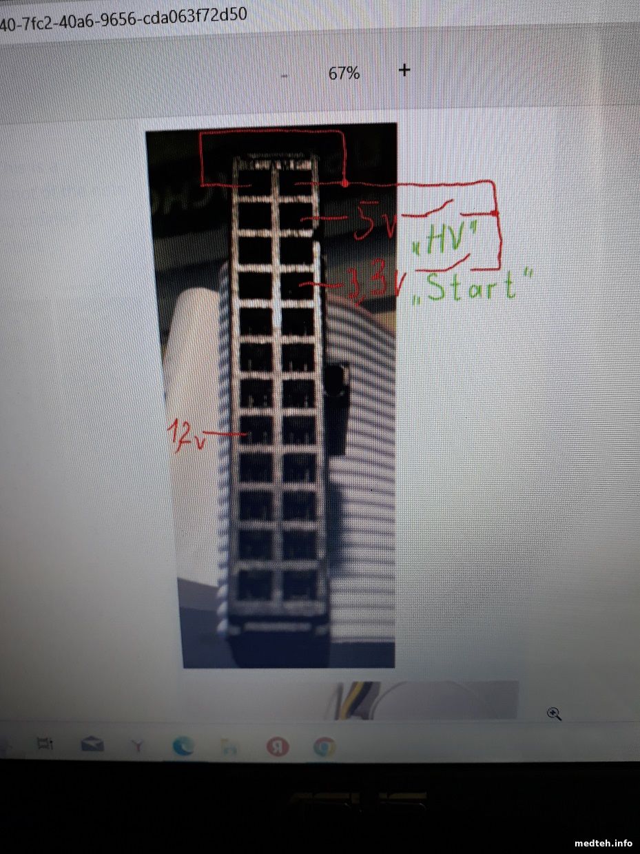

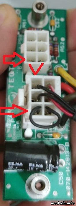

Hello.
When you plug in the power supply, the stand-by part works. However, the inverter part does not work and the AC 150V voltage required for the PC power supply does not occur.
For this, you need to plug the fan sockets into the power supply. So this power supply won't work without plugging in the fan sockets. Or attach a piece of cable to the bottom pins as in the photo, that is, throw a bridge.
If everything is correct, the inverter part works and the voltage is around AC150V for the PC power supply.
Then connect the two slots in the 4th row from the top on the gray cable that goes into the Signal Processing card, which I showed in the last photo. If everything is correct, the power supply works and all the leds turn on. Good luck.
lhagva99Дата: Вторник, 28.Июн.2022, 07:01 | Сообщение # 88
Монголия
Улан-Батор
I did according to your instruction.
Now power supply works and all LEDs are on except LV (it was original issue, I replaced C516 electrolyte capacitor but no any change).
What points shall I check, it seems that LV shares same PWM control with 2.5V, if I am right.
Personal Computer is on and Display shows error "The instrument has detected an internal error" message and restarted. (it was same before).
Regards

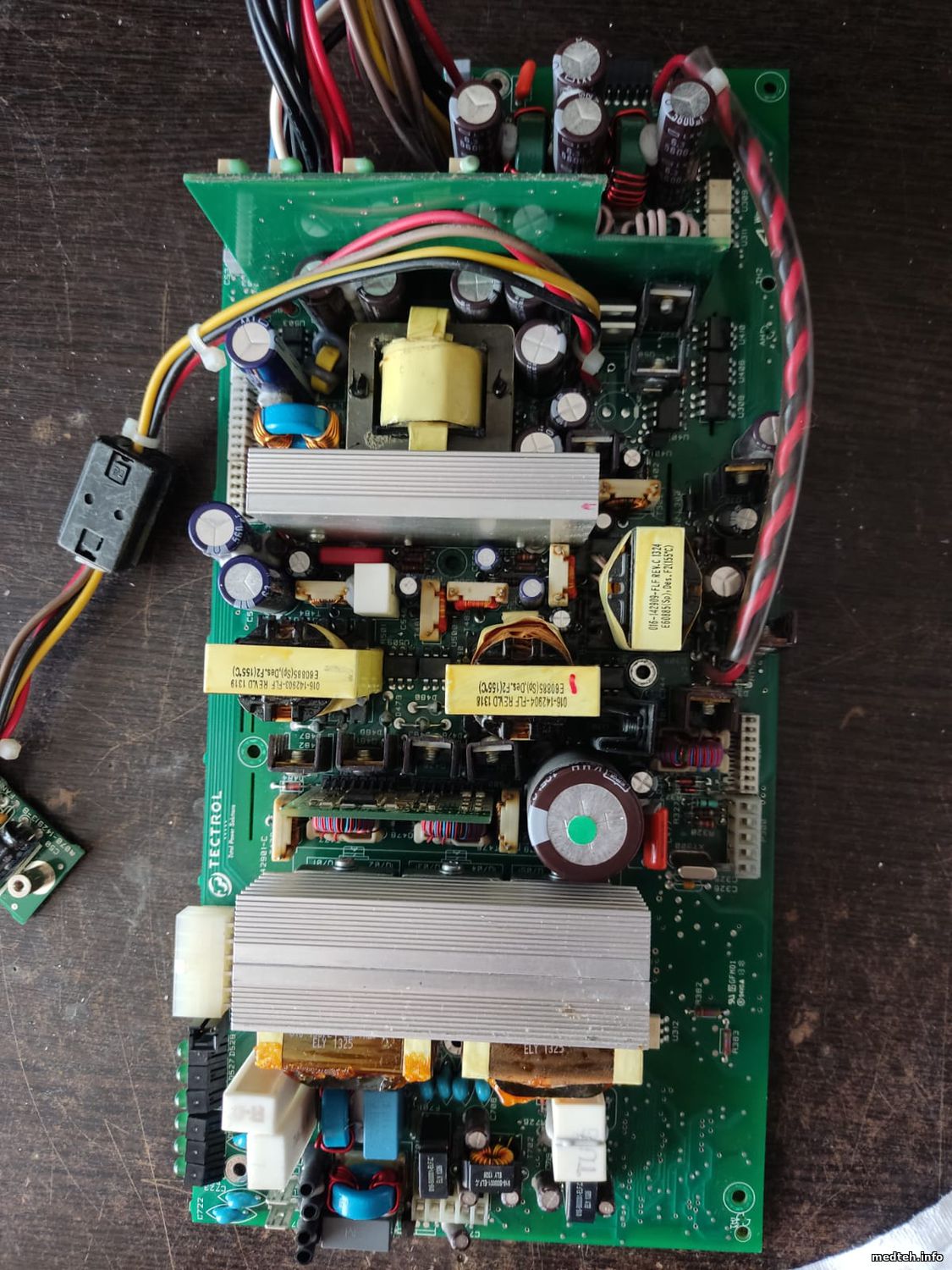

Поступил УЗИ HD11 ХЕ. Аппарат очень чистый, пыли нет совсем. Не включается, даже индикатор АС не светится.
Разобрали БП, нашли сомнительные элементы в APFC и заменили. Индикатор уже светится, появилось напряжение 3.3 В, но нет 120-180 В для питания компа.
При попытке запустить БП появляются напряжения для вентиляторов и ещё 30 В. Нет 5 В для HV.
Подскажите где искать проблему ...
