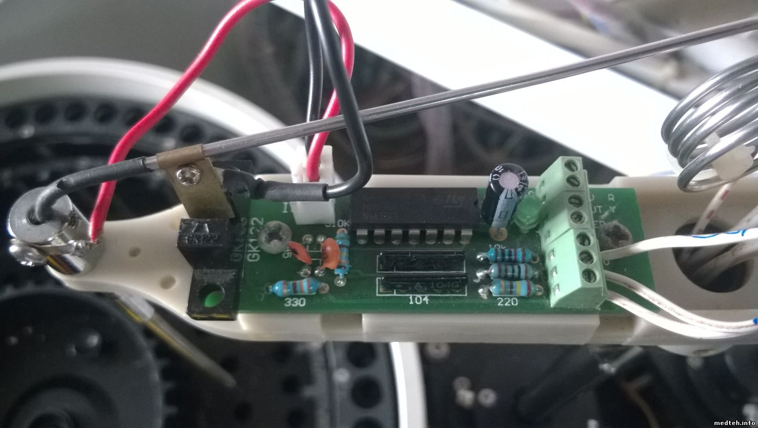

Liquid Level Detect error of FA -200 .help me !

AlexiumДата: Четверг, 12.Июн.2014, 14:15 | Сообщение # 4
----------------- Check connector.

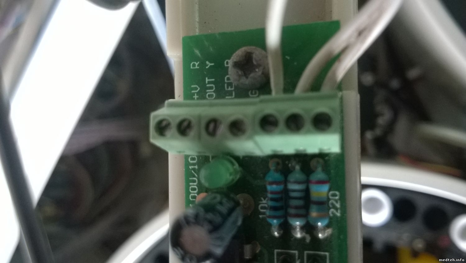

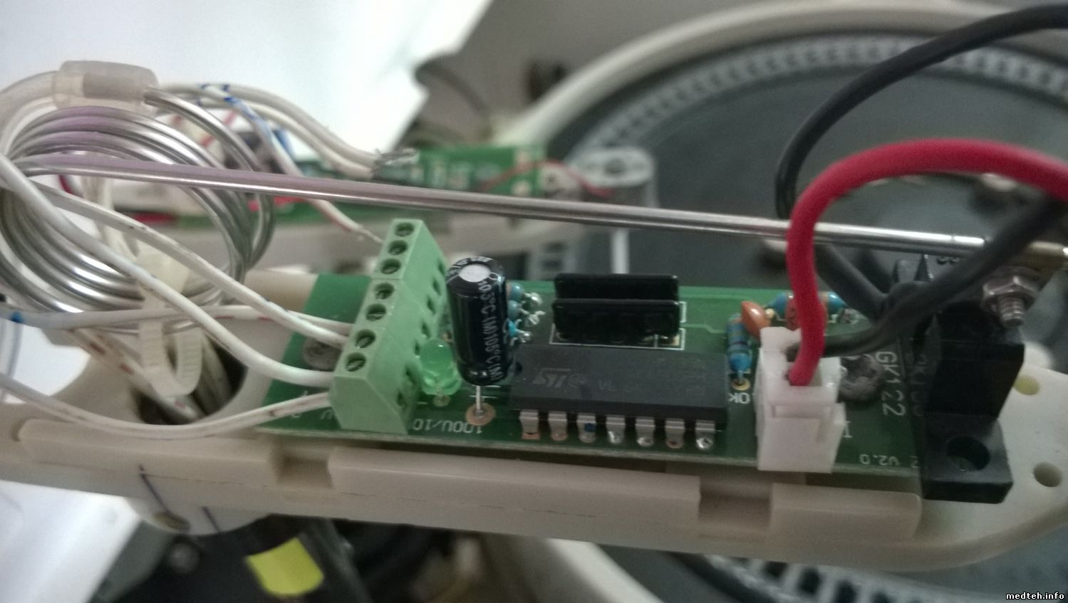

thangblueДата: Понедельник, 16.Июн.2014, 07:34 | Сообщение # 6
technical
Вьетнам
Ha Noi
Hi alexium, thank you so much about your help to me.
I have tried your methods, but not done
The Wire had brocken.I don’t understand about it,that methods they connection each other.
Could you say to me particularly again, please??? Thanks .hepl me

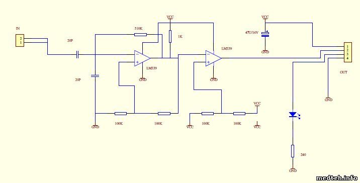

AlexiumДата: Понедельник, 16.Июн.2014, 11:47 | Сообщение # 7
Liquid detector schematic

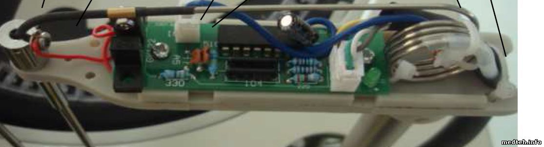

AlexiumДата: Понедельник, 16.Июн.2014, 12:59 | Сообщение # 8
collision detector needle

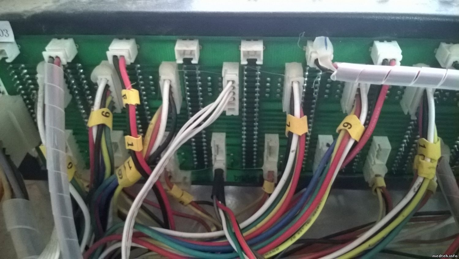

thangblueДата: Вторник, 17.Июн.2014, 07:10 | Сообщение # 9
technical
Вьетнам
Ha Noi
Hi Alex
I connected singal port in LLD Board base on your diagram you sent me, but problem has not resolved
I checked motherboard and I got results as below: (file attach)
