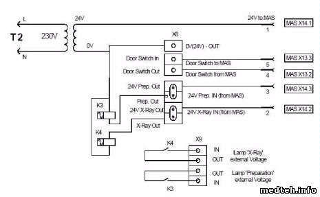

Всем привет. Есть у кого нибудь инструкция по подключению? Конкретно интересует подключение табло "Не входить".

Уточните модель sensation , defenition , emotion ????
Somatom Emotion 16 2012 г.в.
fred1Дата: Пятница, 09.Авг.2019, 18:56 | Сообщение # 12
У вас сообщений: 551
Анапа
External "Radiation Release" and "Ready" lamps: The lamps are provided with voltage from an external source (max. 230V, 2A).
The "Radiation Release" lamp is connected at X9.1 / X9.2
The" Ready" lamp is connected at X9.3 / X9.4.
When using external voltage (on-site voltage supply), the cable has to be labeled accordingly.
External "Radiation Release" and "Ready" lamps (24V):
To connect them, remove jumpers X8.3-7 (Ready) and X8.2-8 (Radiation Release). Relays K3 and K4 (contact X9) are now inactive.
