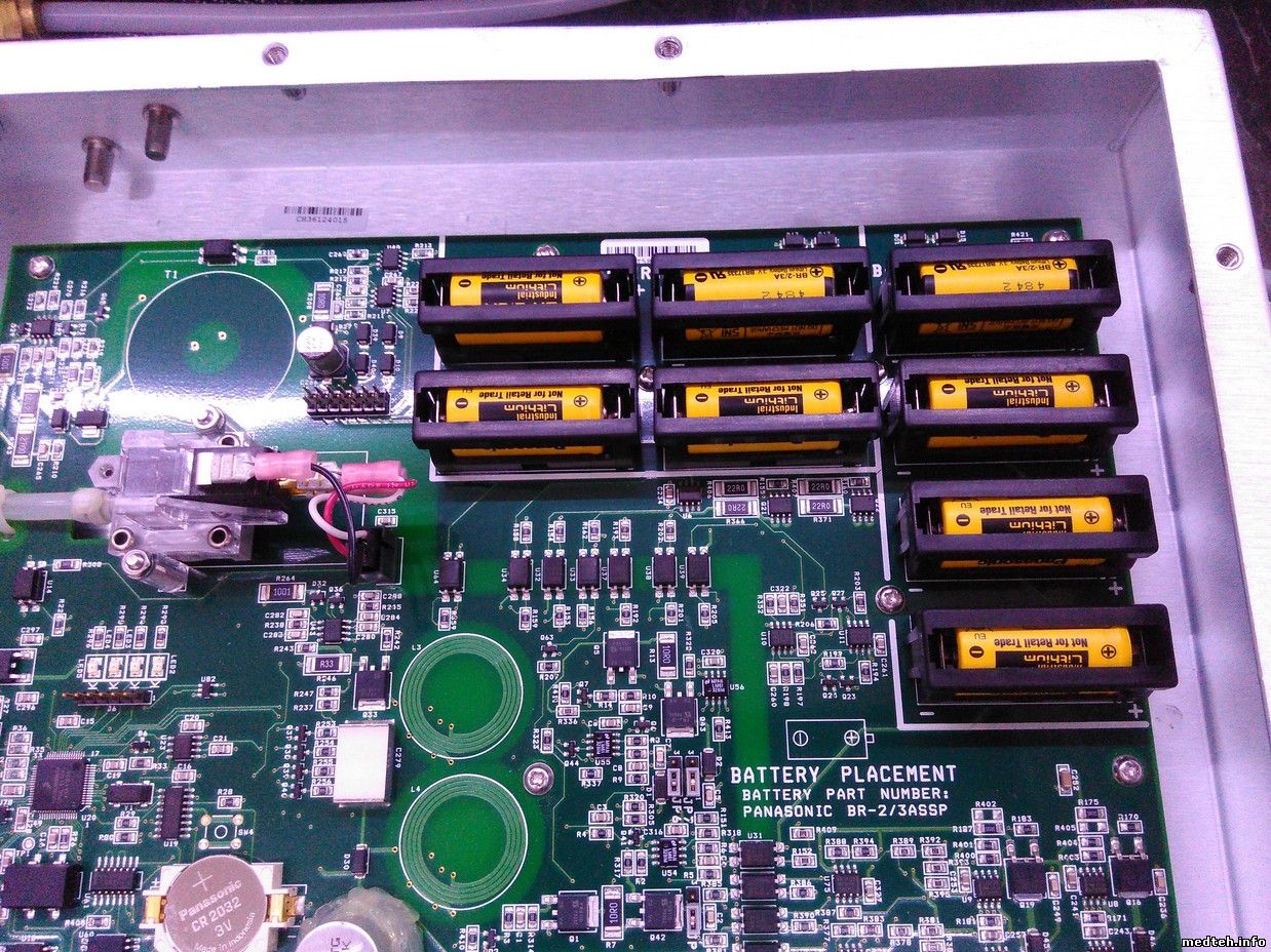

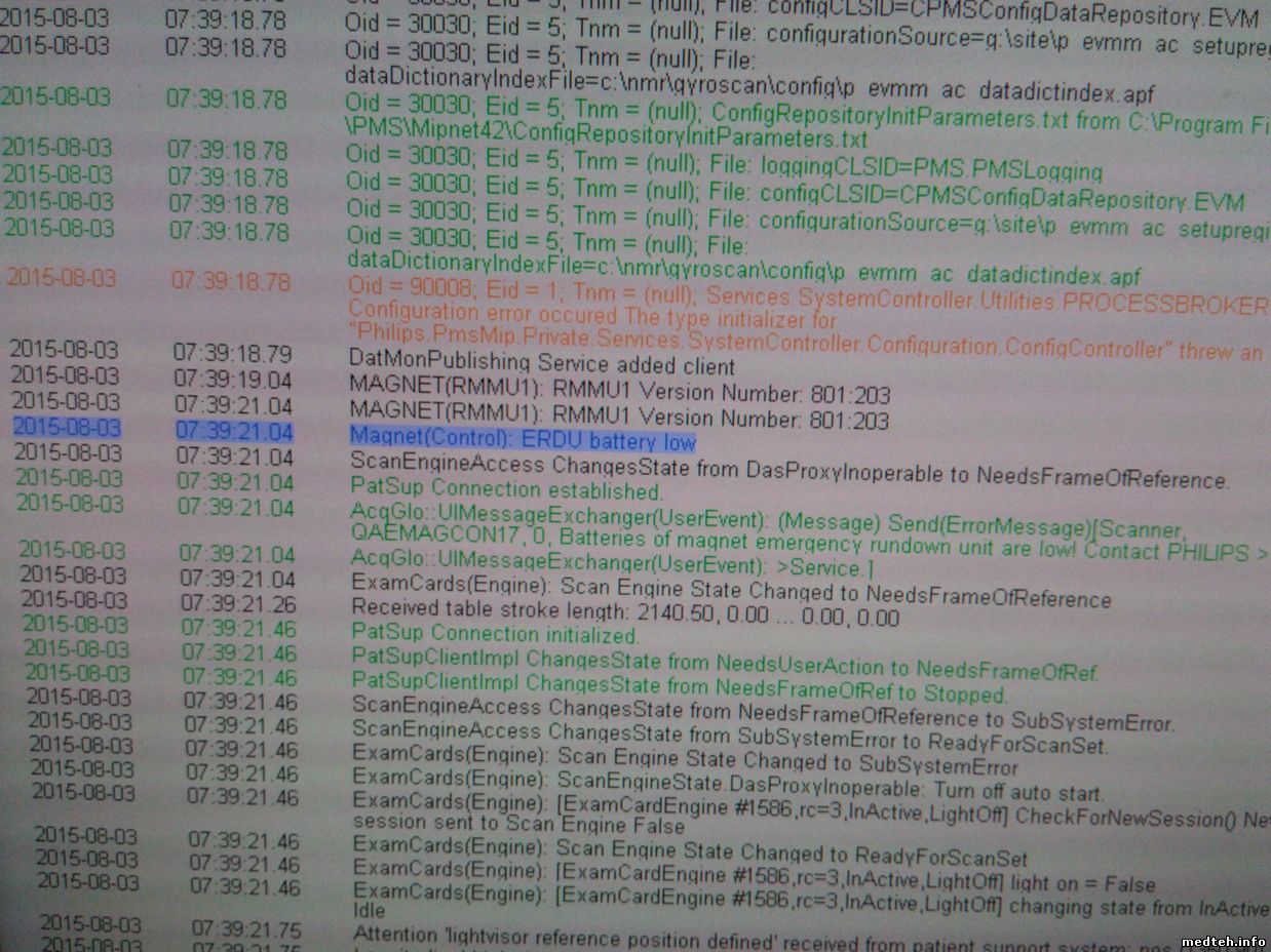

Здравствуйте, на МРТ PHILIPS ACHIEVA 1,5 T каждое утро вылетает ошибка - Batteries of magnet emergency rundown unit are low! Contact Philips Service.(логи имеются).Было предпринято - замена батареек на плате battery placement - результат ноль. Собственно вопрос на сколько критична эта ошибка и как её устранить?
dunakanДата: Четверг, 06.Авг.2015, 23:11 | Сообщение # 2
У вас сообщений: 330
Ростов
На что поменяли, на точно такое же, или подобрали по параметрам?
vat21Дата: Четверг, 06.Авг.2015, 23:18 | Сообщение # 3
нет
Котлас
"Пальчиковые" - заказывали оригиналы. "Таблетку" - подобрал - правда не панасоник....

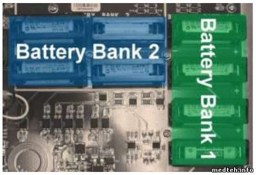

Replacing ERDU circuit batteries in an MEU
1. Disconnect the MEU DC power at the MJ-X1 connector.
2. Disconnect the MEU’s 41-pin instrumentation cable at the MJ-X3 connector.
3. Remove the top cover from the MEU.
4. Remove the battery retaining clips from the first bank of 4 batteries.
Use a small non-magnetic screwdriver with a flat point to remove the battery retainer
clips
 Carefully put in the point of the screwdriver as shown.
 Carefully tilt the screwdriver as shown.
 Be careful. It is easy to cause damage to the battery retainer clips.
The batteries in the MEU are magnetic. They will be attracted to the magnet.
Hold the batteries tightly in your hand when you remove each battery.
5. Remove the four used batteries from battery bank 1.
6. Be careful not to cause damage to the battery retainer clips.
7. Keep the battery retainer clips. You will use them again.
8. Get four new batteries.
9. Install the four new batteries in battery bank 1. Make sure that you install the batteries in
the correct +/- direction.
10. Carefully push in each battery until you fully engage the battery in its battery bank.
11. Carefully push in the four battery retainer clips. Make sure that you fully engage the battery
retainer clips.
12. Connect the MEU DC power again at the MJ-X1 connector.
13. Do the Battery Test in the Service Application on the system computer.
Do not change battery bank 2 unless the test results are correct for battery bank 1. The
ERDU button will not operate unless a minimum of one battery bank operates.
14. Do steps 4 through 13 again for battery bank 2.
15. Put the MEU’s cover back on. Tighten all eight fasteners that hold the MEU’s cover in
position.
16. Connect the 41-pin instrumentation cable to the MEU.
17. Connect the power to the MEU.
18. Discard the removed batteries.

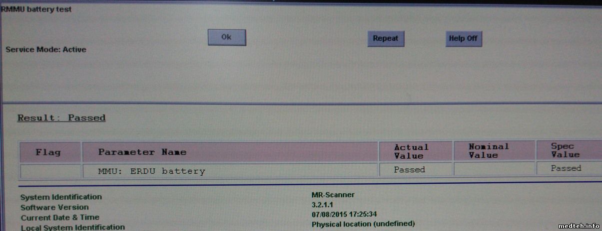

vat21Дата: Понедельник, 10.Авг.2015, 10:34 | Сообщение # 9
нет
Котлас
KVI, Спасибо за помощь...вопрос решен - не был сделан тест...Тему можно закрыть.
