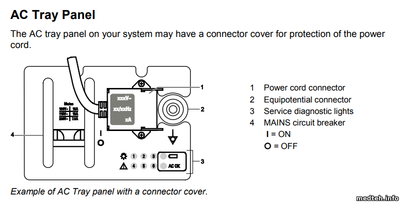

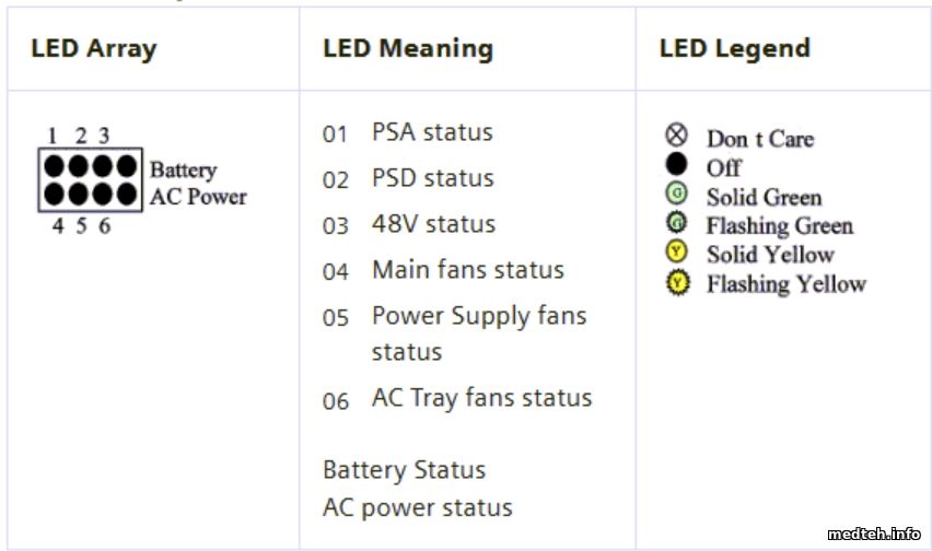

If you know the meaning of the blinking LED, can you tell me please? Led1
valentin17Дата: Воскресенье, 02.Мар.2025, 19:13 | Сообщение # 6
У вас сообщений: 561
Чешская Республика
Прага
LED Status
First led blinking yellow meaning PSA error (overload, over temperature, over/under voltage). If overloaded - this can be caused by the EM, IO, TI, CP, RM or HDD.
