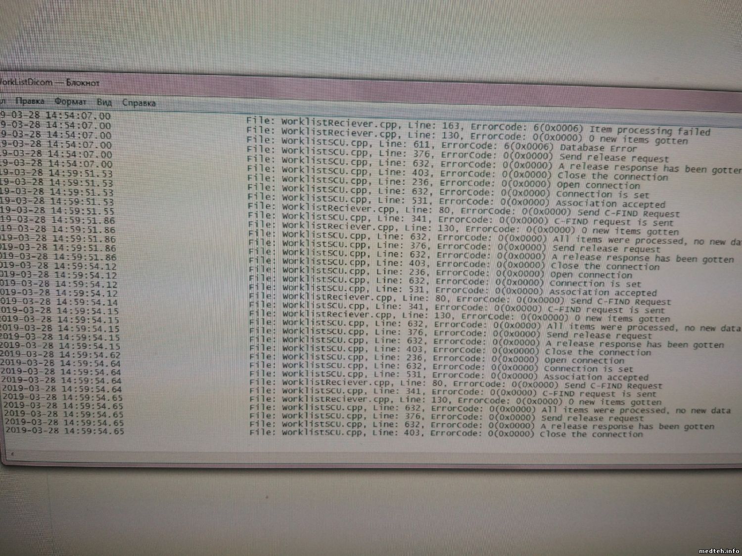

Логи самого аппараты выглядят следующим образом:
2019-03-12 14:42:55.83 File: WorklistSCU.cpp, Line: 236, ErrorCode: 0(0x0000) Open connection
2019-03-12 14:42:55.83 File: WorklistSCU.cpp, Line: 632, ErrorCode: 0(0x0000) Connection is set
2019-03-12 14:42:55.85 File: WorklistSCU.cpp, Line: 531, ErrorCode: 0(0x0000) Association accepted
2019-03-12 14:42:55.85 File: WorklistReciever.cpp, Line: 80, ErrorCode: 0(0x0000) Send C-FIND Request
2019-03-12 14:42:55.85 File: WorklistSCU.cpp, Line: 341, ErrorCode: 0(0x0000) C-FIND request is sent
2019-03-12 14:42:55.86 File: WorklistReciever.cpp, Line: 130, ErrorCode: 0(0x0000) 0 new items gotten
2019-03-12 14:42:55.86 File: WorklistSCU.cpp, Line: 632, ErrorCode: 0(0x0000) All items were processed, no new data
2019-03-12 14:42:55.86 File: WorklistSCU.cpp, Line: 376, ErrorCode: 0(0x0000) Send release request
2019-03-12 14:42:55.86 File: WorklistSCU.cpp, Line: 632, ErrorCode: 0(0x0000) A release response has been gotten
2019-03-12 14:42:55.86 File: WorklistSCU.cpp, Line: 403, ErrorCode: 0(0x0000) Close the connection
2019-03-12 14:43:02.80 File: WorklistSCU.cpp, Line: 236, ErrorCode: 0(0x0000) Open connection
2019-03-12 14:43:02.82 File: WorklistSCU.cpp, Line: 632, ErrorCode: 0(0x0000) Connection is set
2019-03-12 14:43:02.82 File: WorklistSCU.cpp, Line: 531, ErrorCode: 0(0x0000) Association accepted
2019-03-12 14:43:02.82 File: WorklistReciever.cpp, Line: 80, ErrorCode: 0(0x0000) Send C-FIND Request
2019-03-12 14:43:02.82 File: WorklistSCU.cpp, Line: 341, ErrorCode: 0(0x0000) C-FIND request is sent
2019-03-12 14:43:02.84 File: WorklistReciever.cpp, Line: 163, ErrorCode: 6(0x0006) Item processing failed
2019-03-12 14:43:02.84 File: WorklistReciever.cpp, Line: 130, ErrorCode: 0(0x0000) 0 new items gotten
2019-03-12 14:43:02.84 File: WorklistSCU.cpp, Line: 611, ErrorCode: 6(0x0006) Database Error
2019-03-12 14:43:02.84 File: WorklistSCU.cpp, Line: 376, ErrorCode: 0(0x0000) Send release request
2019-03-12 14:43:02.84 File: WorklistSCU.cpp, Line: 632, ErrorCode: 0(0x0000) A release response has been gotten
2019-03-12 14:43:02.84 File: WorklistSCU.cpp, Line: 403, ErrorCode: 0(0x0000) Close the connection
Тестировал сервер программой IQ_DICOMTest, и она отображала все ворклисты,но без запланированной процедуры (что странно, т.к. у некоторых записей разные AET конечных устройств), уже и не знаю как еще попробовать заставить эту связь работать, предполагаю, что ошибка в шаблоне ворклиста, хранимого на сервере, раз он обращается к нему и не получает никакие записи, но как правильно не знаю и нигде не нашел. Буду очень признателен за любую помощь, заранее спасибо.

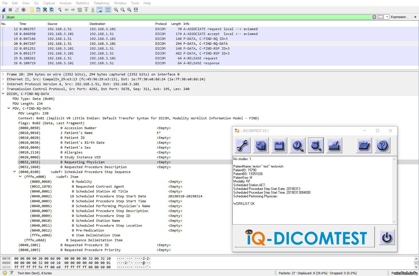

берите wireshark, и сравнивайте запрос из программы и с iQ_DICOMTest
а вы данные для ворклиста откуда берете?
не проще ли conquest запустить, а в нем ворклист сделать в виде sql view к нужной базе данных

Попробовал отловить пакеты, с рентгена Wireshark-ом, но ничего не вышло. Он как будто их не ловит, хотя когда я IQ_DICOMTest посылаю на сервер запросы, WS прекрасно это видит, ну также как и на вашем скриншоте отображается последовательность пакетов. И теперь я вот думаю, верификацию то сервисы проходят, что Storage, что Worklist, но WS упорно не обнаруживает пакеты, которые должен слать рентген. Но на сервер исследования то приходят... shok

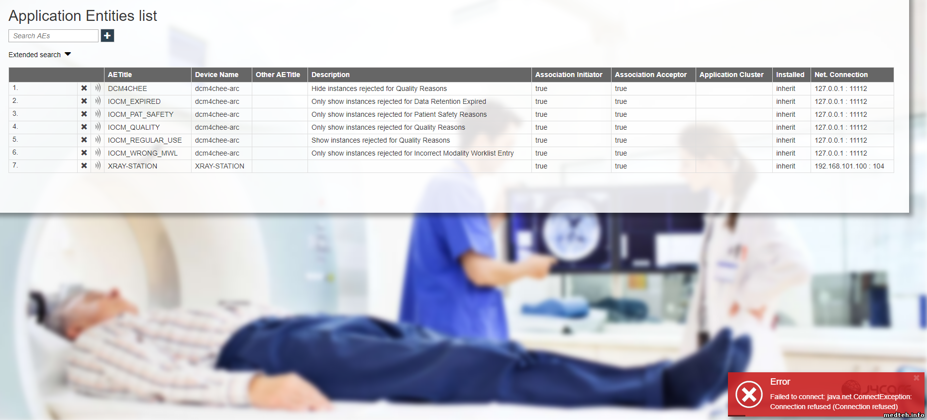

Так вот, если я добавляю на сервере в Application Entities list с IP станции лаборанта и портом 104 echo запрос с DCM4CHEE не проходит (см. скриншот), хотя наверное должен
не должен.
Логи из первого поста вы откуда взяли?
В любой непонятной ситуации используйте tcpdump (с)
Плясать надо от печки (с)
Запустите на dicom-сервере tcpdump, и убедитесь что запросы приходят именно с лаборантского компа. Мне кажется, у вас там рояль в кустах есть.

1) Логи были взяты из файла DicomWorklist.txt (что-то типо того), расположенного то ли на сервере рентгена то ли на АРМ лаборанта (не могу точнее сказать, не посмотрел куда монтировались диски)
На удивление tcpdump и wireshark не могут отловить пакеты при передаче снимков на ПАКС и запросе ворклистов, хотя логи сервера Wildfly во время запроса ворклистов выглядят так:
2019-03-28 15:33:42,796 INFO [org.dcm4che3.net.Connection] (EE-ManagedExecutorService-default-Thread-2) Accept connection Socket[addr=/192.168.101.1,port=50174,localport=11112]
2019-03-28 15:33:42,797 INFO [org.dcm4che3.net.Association] (EE-ManagedExecutorService-default-Thread-33) DCM4CHEE<-QWERTY(49) >> A-ASSOCIATE-RQ
2019-03-28 15:33:42,797 INFO [org.dcm4che3.net.Association] (EE-ManagedExecutorService-default-Thread-33) DCM4CHEE<-QWERTY(49) << A-ASSOCIATE-AC
2019-03-28 15:33:42,802 INFO [org.dcm4che3.net.Dimse] (EE-ManagedExecutorService-default-Thread-33) DCM4CHEE<-QWERTY(49) >> 146:C-FIND-RQ[pcid=1, prior=1
cuid=1.2.840.10008.5.1.4.31 - Modality Worklist Information Model - FIND
tsuid=1.2.840.10008.1.2 - Implicit VR Little Endian
2019-03-28 15:33:42,803 INFO [org.dcm4chee.arc.procedure.scp.MWLCFindSCP] (EE-ManagedExecutorService-default-Thread-33) DCM4CHEE<-QWERTY(49): Process MWL C-FIND RQ:

Логи рентгена выглядят следующим образом, он пишет как будто не нашел никаких новых заказов на исследование (см. скриншот)
