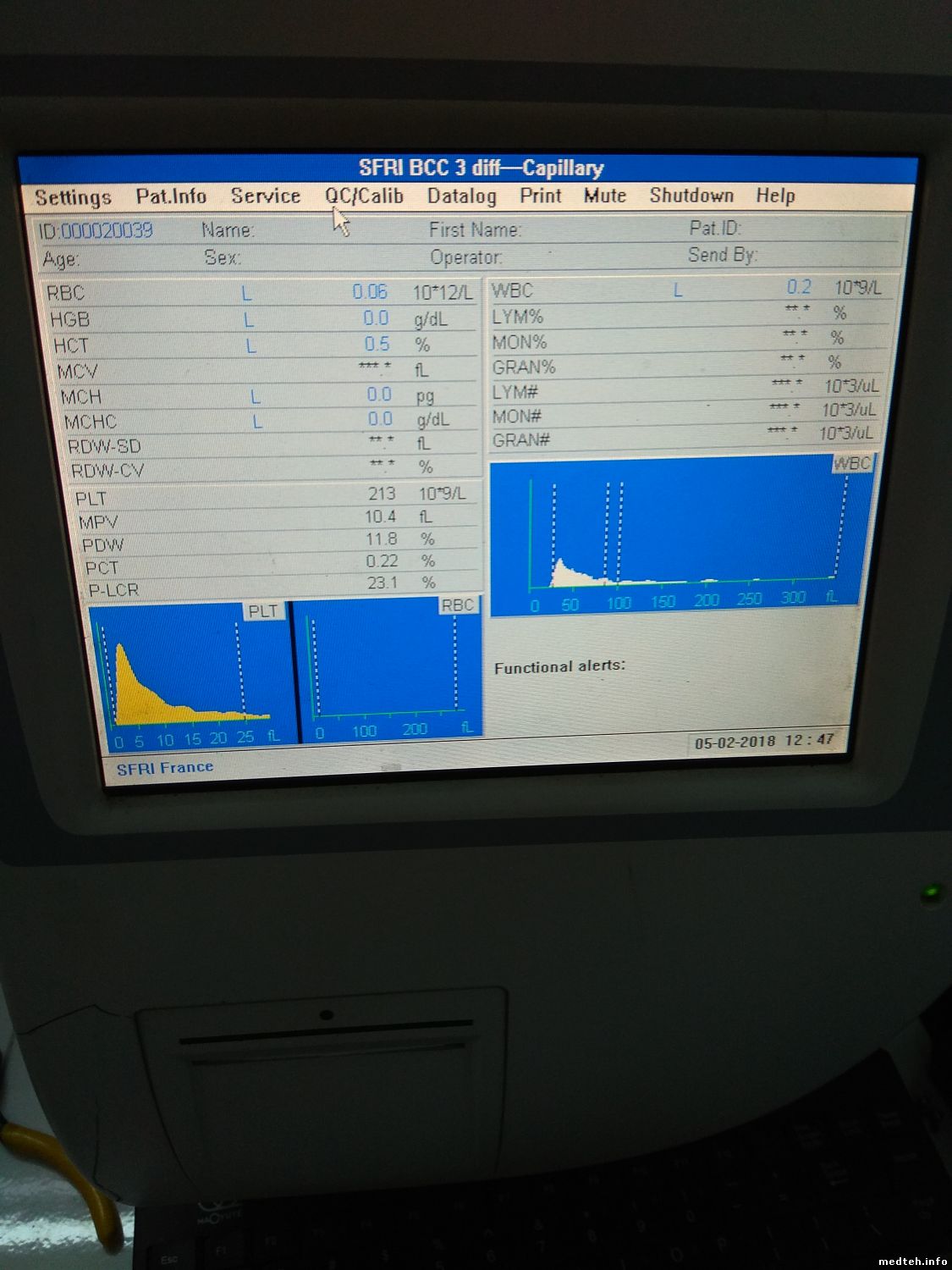

Кто поможет мне PLT SFRI?
Очищены и заменены счетчики RBC
Замененный раствор разбавителя и промывка
Теперь я не знаю, что делать?

heatpump84, - bad electrical ground, bad power supply, chamber crack and micro bubbles in aperture.

This SFRI had connected well with ground.
I had replace new chamber.
Replace new diluent and no bubbles in aperture.
Get an new sample RBC is the same result with XP100.
This machine just have an trouble with PLT.
I can't understand.

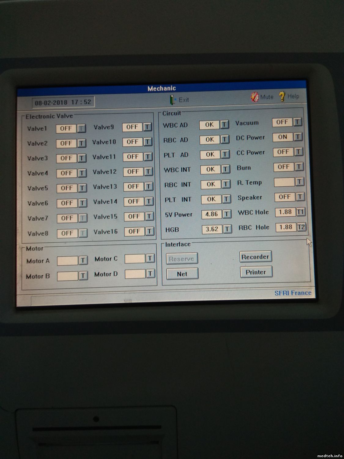

Dear Sir, is it possible to remove a connection between RBC chamber and amplifier, and run a sample. If evevrything in "red" row is "0", then you'll be sure that no problem with an amplifier is present. So, sorry, I am not familiar with the mneu, but there must be a "noise" test - check it. And, in the instrument is there a motor gear, which can make you a noise /if there is, check a ground, visualy it can be OK, but sometimes it loose a connection/? Sorry for long post, just send my opinion.

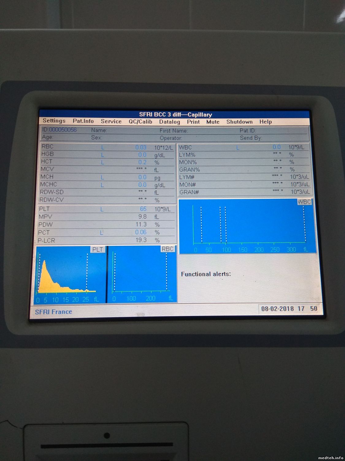

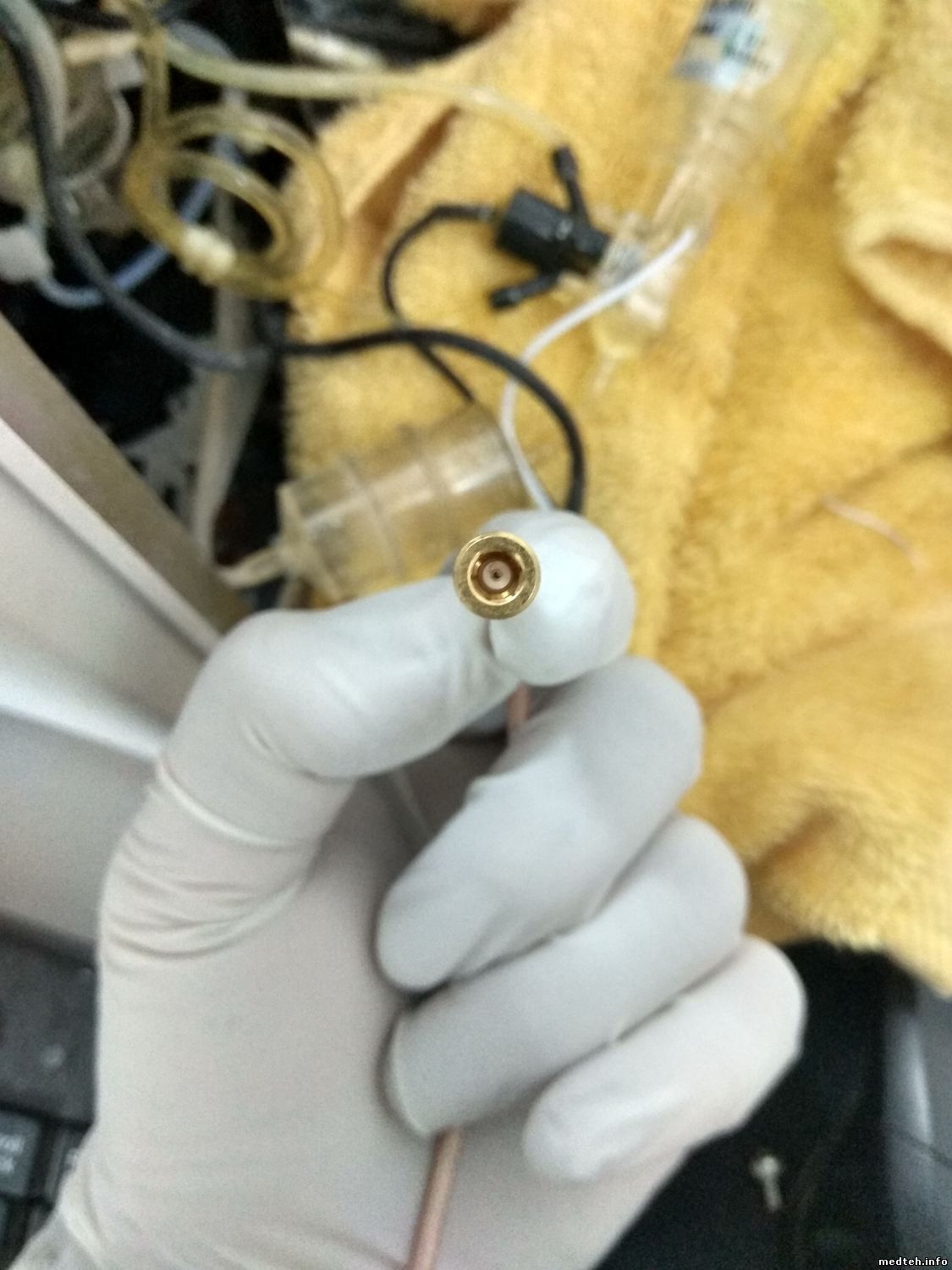

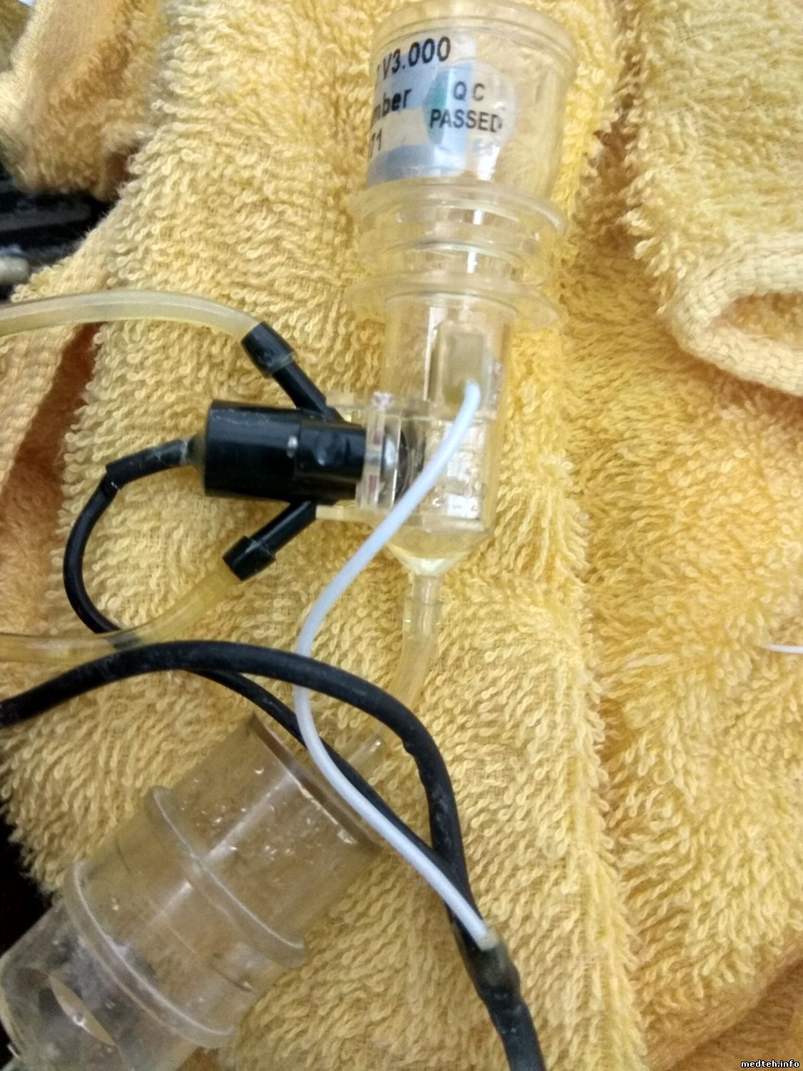

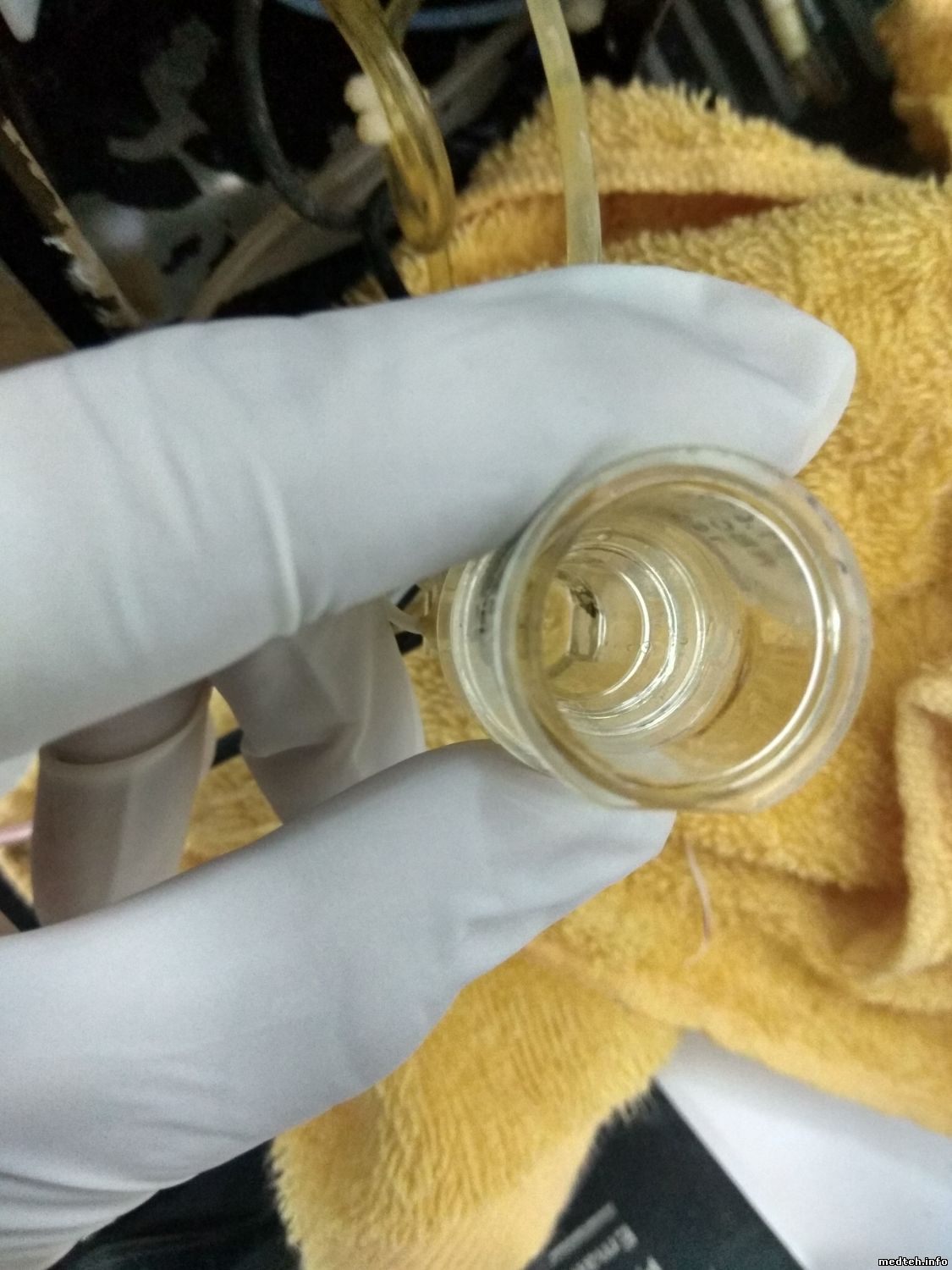

Dear Tzaneff,
I had tried disconect RBC chamber and run a sample everything -0 that i can sure CCU board ok.
But when reconect RBC and run sample all result very bad.I had used a scalpel clear surface of electrode and run sample, the fist result very good all thing are zero, the second result PLT -65 and the thrid PLT-151.
I guess new RBC chamber have problem.

AlexiumДата: Пятница, 09.Фев.2018, 23:25 | Сообщение # 15
Dear friend, make some photos of the internal analyzer. Chamber like a Mindray!

And as opinion - dear heatpump84, can you try replace RBC cable with WBC cable, and run a blank sample? In this case, if you have some cell counrted in WBC channel, then you'll be sure that as you sais a problem is somewhere in the cable, or chamber it self. Best regards.
