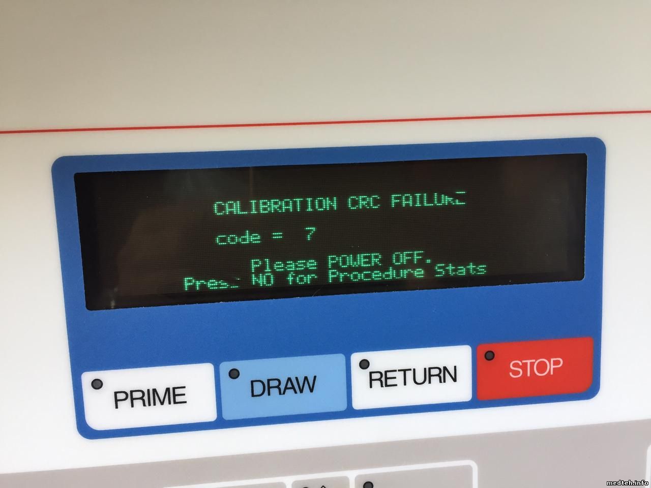

Можете помочь с калибровкой аппарата?
http://www.medteh.info/_fr/110/9218095.jpg
Вот такую ошибку выдаёт:
maksai1990Дата: Понедельник, 02.Авг.2021, 21:05 | Сообщение # 13
У вас сообщений: 91
Поволжье
gladiator, Каким образом помочь?
1. Select Calibration using the MODIFY PROGRAM and DRAW keys. Toggle the write protect switch on the processor board when instructed. (Remove rear access panel.)
2. Select A/D Calibration by pressing the DRAW key.
3. Record the values for the offset and full scale values for the Cuff, Weigher,
DPM and SPM.
4. Press the STOP key to back out of A/D, then press the MODIFY PROGRAM key to select Centrifuge. Press DRAW.
5. Perform the Centrifuge Calibration, page 4-16. Record the Outval readings for 3000 and 8000 RPM.
6. Press STOP to exit Centrifuge and then press MODIFY PROGRAM to select Safety System. Press DRAW. Perform the Safety System calibration,
page 4-17. Record the following and ensure they are in specification: Normal (1920 - 2194), Low(1265 - 1620), High(3260 - 4080).
